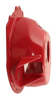

Got my clutch parts today. Pretty exciting. I need to get some plate steel and fab up a little mount to weld to my lakewood. I hate not having enough tools. I need to pop a 1 7/16" circle hole and I have no way to do it.
(I'm missing a -3AN-3AN male-male union to mate the line to the master) Get that Monday.
I was concerened I'd only be able to find a plastic camaro slaves. This is a duralast unit for $35.
The mount I need to make is similar to this.
__________________
DE OPPRESSO LIBER
