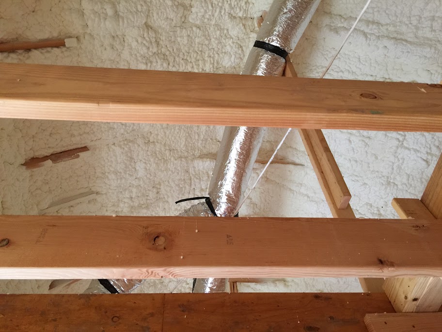

                    I had ridge vents installed back in 2012 when I got a new roof. My house is a POS Drees 1400' house with 3 small ridges. I fucking hated them, my attic temp in the summer would reach north of 160 degrees. My house with a brand new 17 seer A/C wouldn't cool below 80 degrees. I suspected that I didn't have enough soffit vents, checked one day, I have 18, more than enough. I gave in and put an electric fan up there, went with a standard cheap fan as a proof of concept before I dropped the $600 on a solar unit. The difference was nearly instant, my attic now hovers right around 10 degrees above ambient.
                      Sealed attics or give me death.
                        I agree, sealed attic is best, but in a retrofit situation this is not easy or many times cost effective.
                        We are going with sealed attic on our new build. Never made sense to me to run duct work through a non-insulated space.
