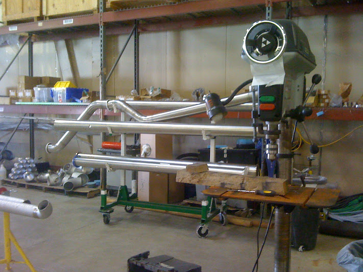

Drill press that we were using to saddle some 1.5" stainless water lines today, and behind that is a 3" stainless Foreline that i helped draw up last week on-site, and came to the shop this week to build. and go back to the site tomorrow to install/tie-in.
