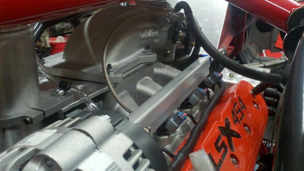

No I used a factory take off harness and began to modify it. It's really easy just very time consuming the way I am doing it. I want the wires as much out of the way as possible but with minimal cutting required. Thus far I have only soldered about 10-15 wires and mostly due to needing them shortened. The oxygen sensor wires were very long so I cut them down, coolant temp needed a little added, couple ground wires needed shortened, and I put all the power wires to the coils and injectors on one wire per side and running them to its own fuse. Other then that it has layed out nicely. I plan to used a couple clamps one on the back of each head to hold the harness in place so it can't move around.

Did a little work to the intake, finished smoothing the top. I plan to add a couple coats of filler primer, hit it with a quick sanding by hand to help smooth some of the bumps out and throw some black on it.
Also worked on the heads and got the porting all finished up. Plan to assemble them tomorrow and get them installed! Hoping to fire it up first of next week!
