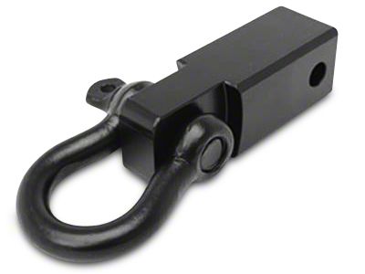

Of course, you need good recovery points on your vehicle.. A place to connect straps or ropes, that will support the forces of yanking and towing. Your recovery point should connect to your frame for the best result, and most factory bumpers are highly inadequate. There are recovery hooks you can buy and bolt to your frame, of course you need to be sure you use quality hardware (like grade 8 bolts). NEVER ATTACH A STRAP OR ROPE TO YOUR TOW BALL, ESPECIALLY TO 'YANK' A VEHICLE! Tow balls will sheer off and become a baseball sized cannon ball. Most people don't realize, if you are going to attach a strap to your hitch, you are best off just using a quality hitch pin and attach the strap to that:
I bought one of these when I had the Suburban before I knew about that last part, and they work too, but generally speaking you want to use as few connections / shackles / etc. as possible, to avoid introducing more potential failure points.
