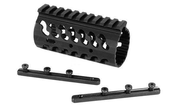

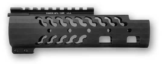

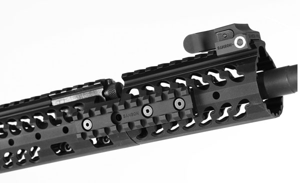

 Well, good news I suppose! I called Samson MFG because I honestly didn't understand wtf their evo rail did exactly. Their website is fairly confusing.
 I spoke to Andrew up there and he was great. Apparently, all of their evo series rails have a gap for a piston setup. Then, you can extend the rail another 4" on front of that. Pretty damn cool!
 Which means I could buy their pistol gas block rail, which is 4" of top rail, and 3" of side rail. Then add the 4" extension, and I have a complete rail with access to my piston block which measures 11" total. Meaning 2" of my suppressor will be inside the rail (and it's 1.65" ID so it will fit!), and 7" will be exposed. So that's awesome. The best part is their rails are pretty cheap ($165 for the rail I'm looking at). And their huge ID is awesome."When the people find that they can vote themselves money, that will herald the end of the republic." -Benjamin Franklin
