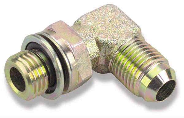

      Those fittings seem to be very close to the sway bar, dont they make a 90* that can screw into that spot instead of the straight fittings?
      EDIT: I realize this is the wrong size but something like this?
      Free Shipping - Holley Pro-Jection Service Parts with qualifying orders of $125. Shop Fittings and Adapters at Summit Racing.
          http://www.summitracing.com/parts/HLY-9906-127/
          Here is what I am going to end up with if I don't geel safe spacing the tank down.
                    That sure is a lot more room with this tank, so yeah, more sewer pipe room for sure.
                    I'm guessing the 90 you have here should work just fine.
