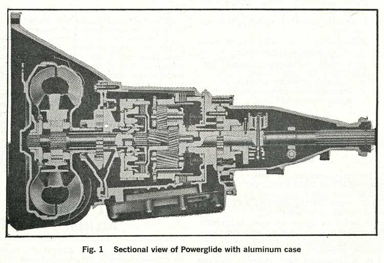

                        my vote, no controller needed (besides yourself)
                          And easy as hell to work on yourself.
