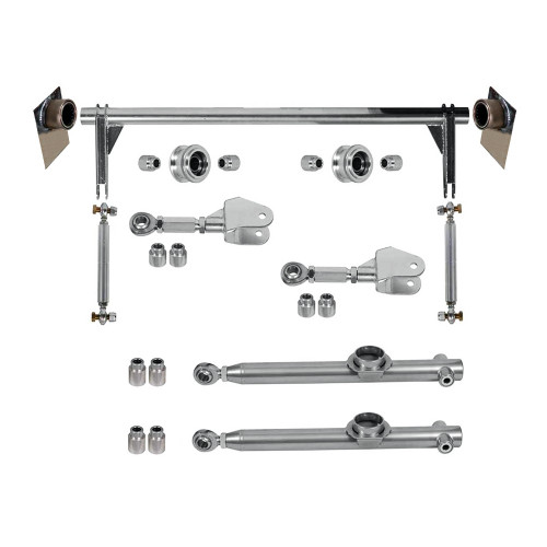

    The rear is where I need some feedback
    I have been looking at this
    But curious which springs I should use and what rear shocks.
    Thanks all and if you have something they you feel would be a better route please speak up.
    Thanks
    Dan
    Strange 10 ways, stock springs with a coil cut off, set your pinion angle according to poly or hiem joint control arm bushings
    This will get you pretty close

      I would skip the upr kit and do Wolfe Racecraft adjustable uppers and lowers,with poly chassis end and spherical axle ends (on the lowers). Stock sway bar, strange 10 way shocks and cut stock springs.
        this....
          X2 Wolfe>upr
            Can any of you guys share some links to these parts from Wolfe? It doesn't look like they make the poly ends now. I have to order the cage tomorrow from them anyways.
            I was also told that the car has a QA1 sway bar under it.
