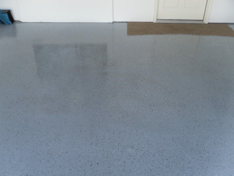

the stuff in my pictures above is roughly $43/gallon, 1 gallon of 100% solids covers 200 square feet at 8 mils thick (NO THICKER) on a first coat to keep from outgassing. Once you mix a kit you better hustle, 24 minutes later you better be done trying to move it around.........pinto gt with wood trim

Nothing you can buy as a non trained installer will look like my pictures above. However, all the shit people are trying to peddle you will have pictures of pro materials. Pro materials arent sold to non trained installers because if installed or mixed wrong it will burn your house to the ground....pinto gt with wood trim
wow that's cheap per gallon... very cheap. So why the fuck does it cost 8-12 a foot? Like someone else said that's the cost of concrete. I just don't get the correlation of overall cost when the product you're talking about (pro products) is cheaper than my DIY job that I'm more than happy with. If it could be done pro for around $500 I totally think it would be worth it, but that's a huge overhead for installation if you ask me. Of course I'm talking one color only w/ no designs or color separationsOriginally posted by Grape View Postthe stuff in my pictures above is roughly $43/gallon, 1 gallon of 100% solids covers 200 square feet at 8 mils thick (NO THICKER) on a first coat to keep from outgassing. Once you mix a kit you better hustle, 24 minutes later you better be done trying to move it around.........
